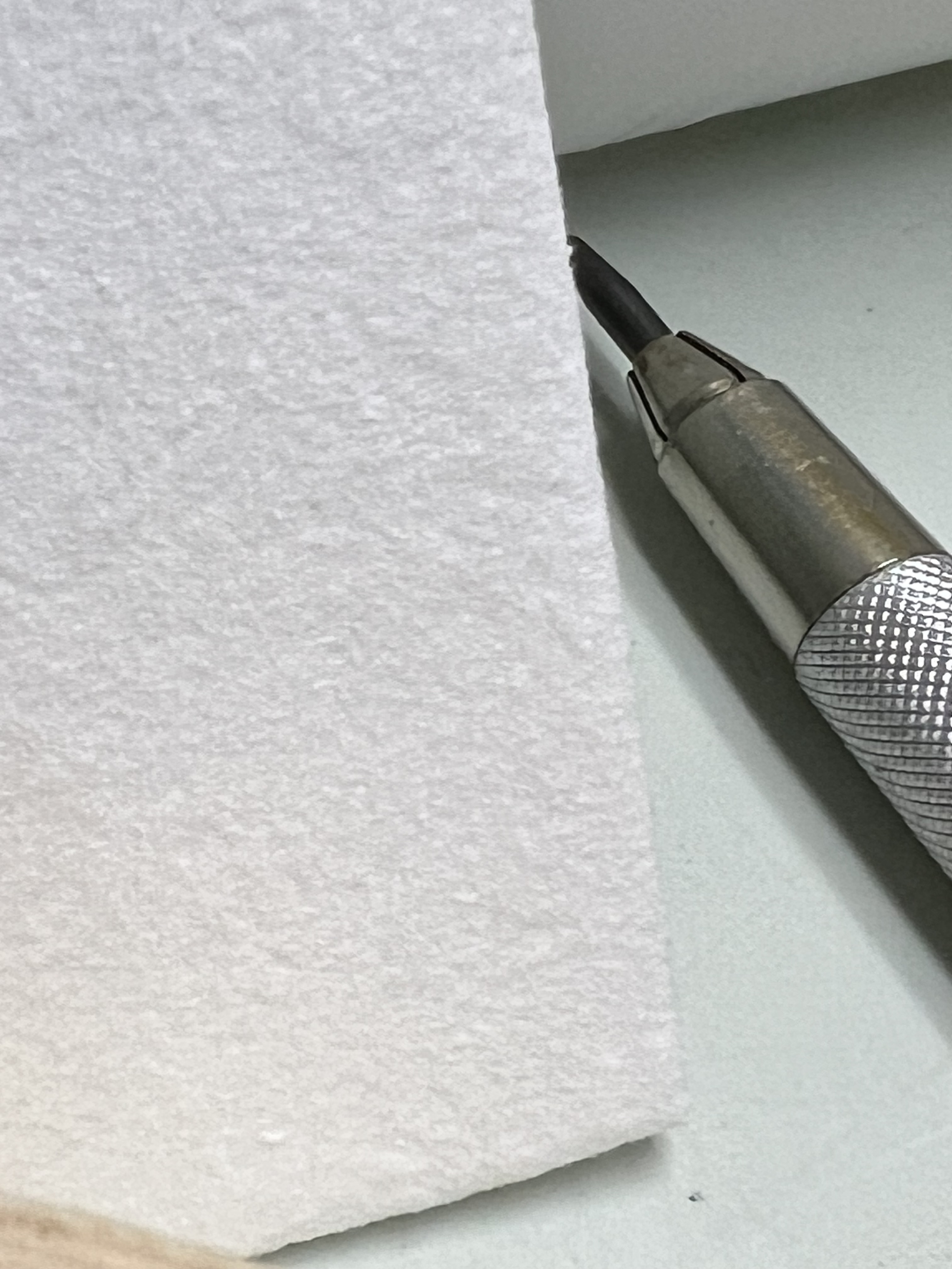

On closer examination, it also looks kinda like a felt kind of texture. You could probably purchase this texture from Poliigon and apply it to the material graph.

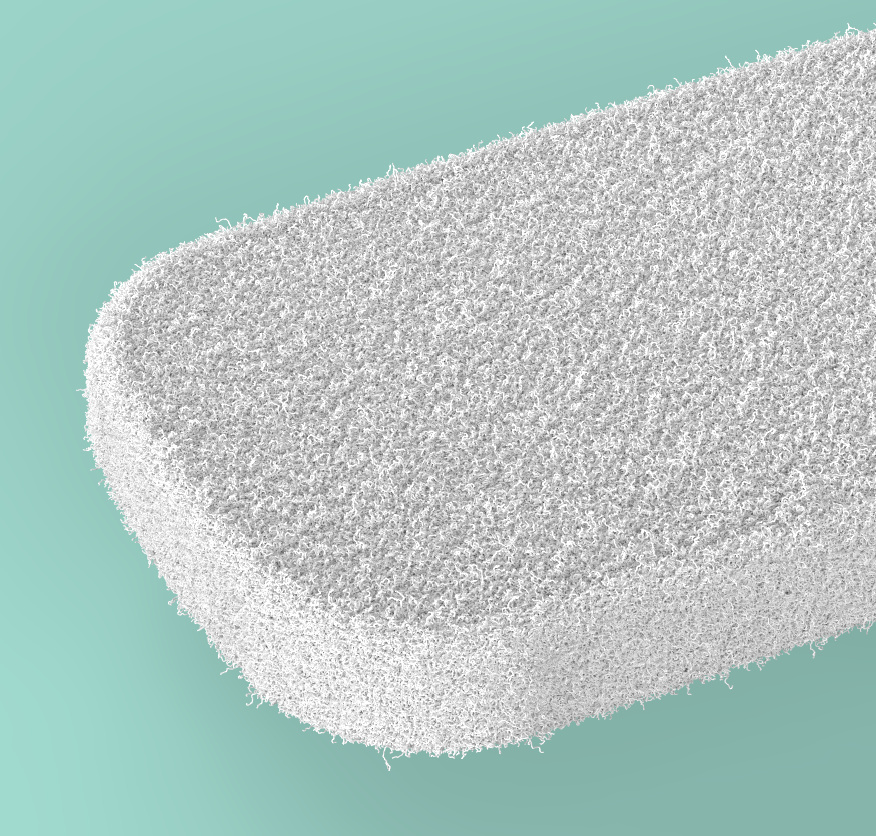

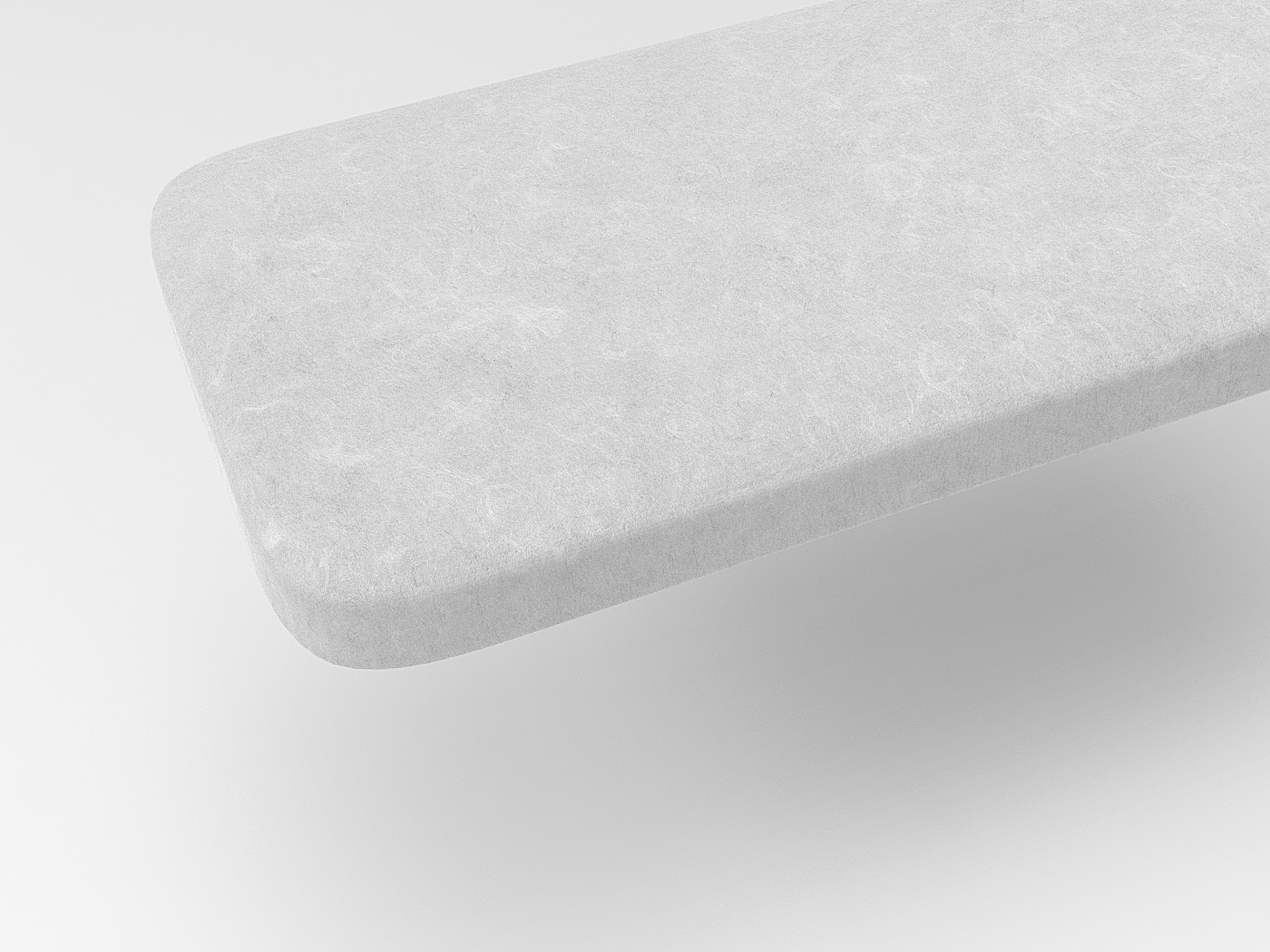

That does look pretty good. I think what I was trying to do is modify a fly away fiber material so that the fibers lay down on the surface but what you show looks like a great compromise to that level of detail. Is this something you can share?

I think scale is really important, because fibres will have a certain size. What I did was using a mask I created from ‘Himalaya Paper’ as scattering medium so it would be a bit translucent. On top of it I placed also that texture as label but mirrored. Just for some structure.
Than I also rendered ‘fibres’ in Photoshop which I used as a label as well with. Both labels are not full opaque but you need a bit of structure at the top I think.
I also played with some displacement but that caused also caused tiny shadows which made it look too dirty and because the base material is quite translucent you don’t want shadow of the structure itself.
Not sure if you actually need the ‘scattering medium’ node. But I think you that really depends on how the real thing looks at that size and if you could for example almost look through it or not since it’s only 2mm.

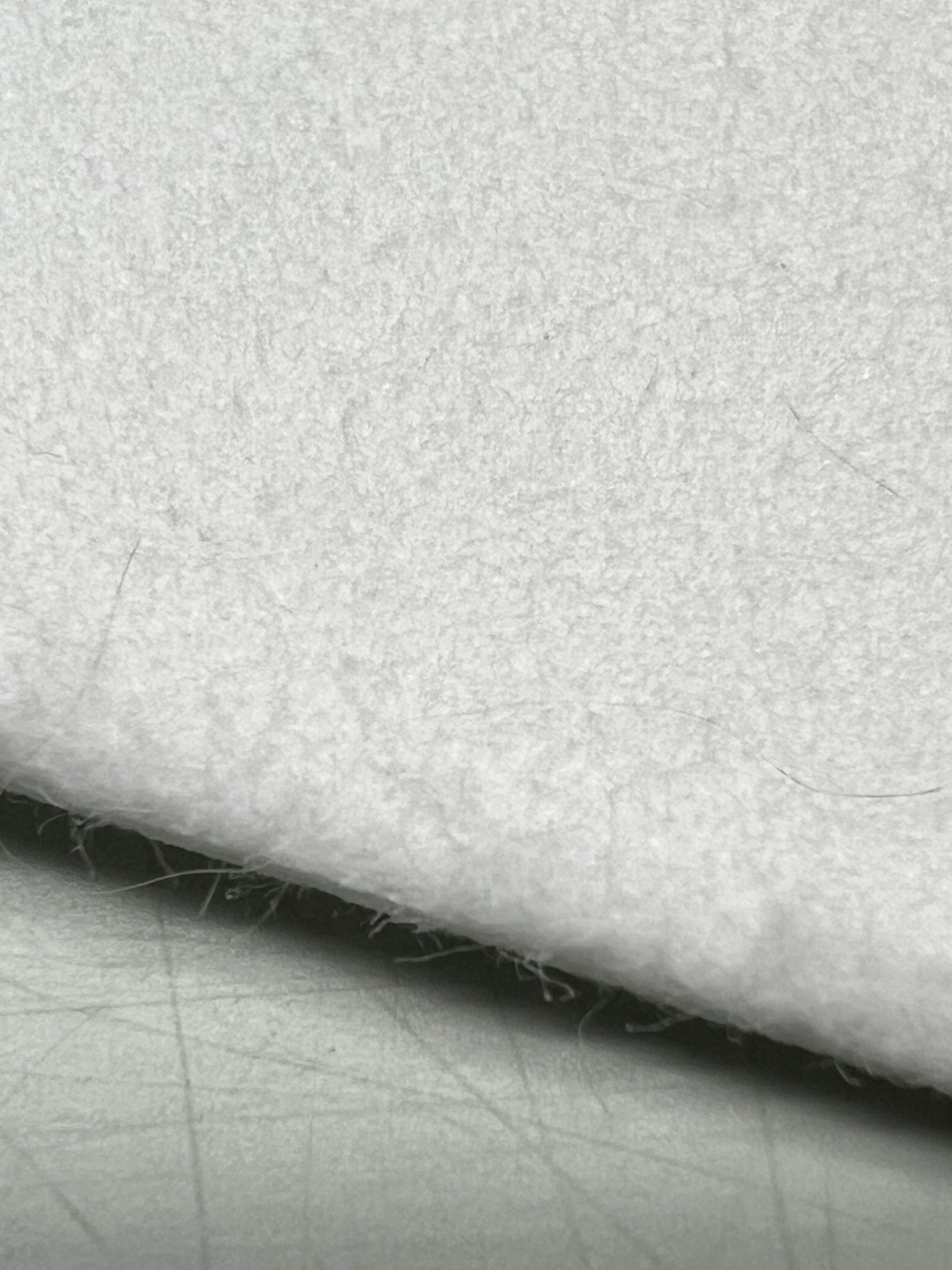

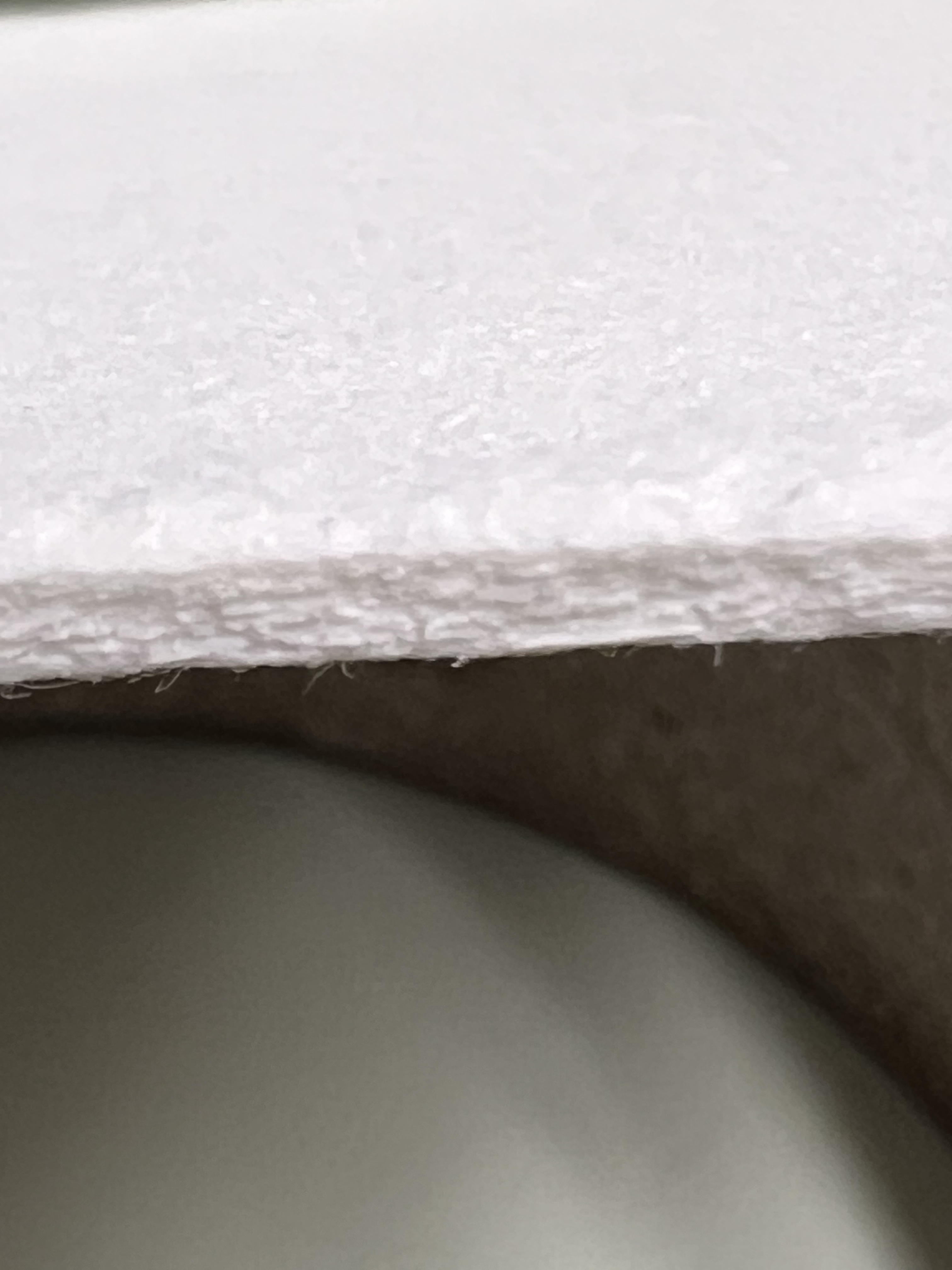

I will take a look and see how this appears on the geometry. The material is almost paper like but imagine a piece of paper about 2mm thick with small fibers visible on the edges. I am just glad someone on here is willing to help me out. I’ll send you a screen shot once i get the hang of the material tree and make modifications if necessary. Thanks again. John

You are absolutely right the material is really heavy to render. That’s mainly because I used the scattering medium material node.
My idea was a bit that you need some kind of sub surface scattering since the pad is not as solid as for example a piece of plastic. If you would shine a really bright light on it I assume the light penetrates the edges of the pad.
If you can post a macro image of the actual material it might help others but maybe you’re under NDA. I do get the fibres on the side of the pad, They would appear pretty long I can image because the pad is so small.

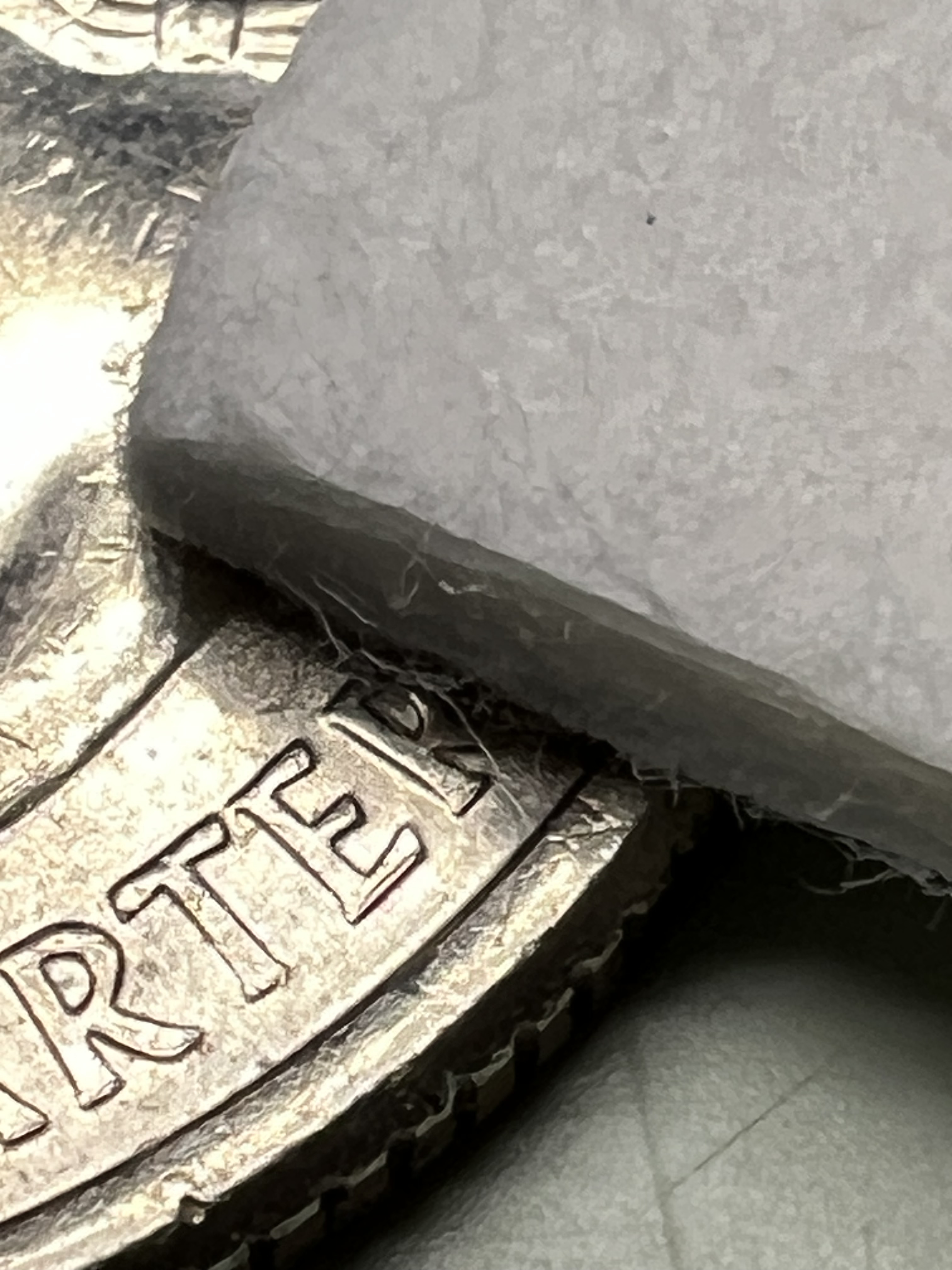

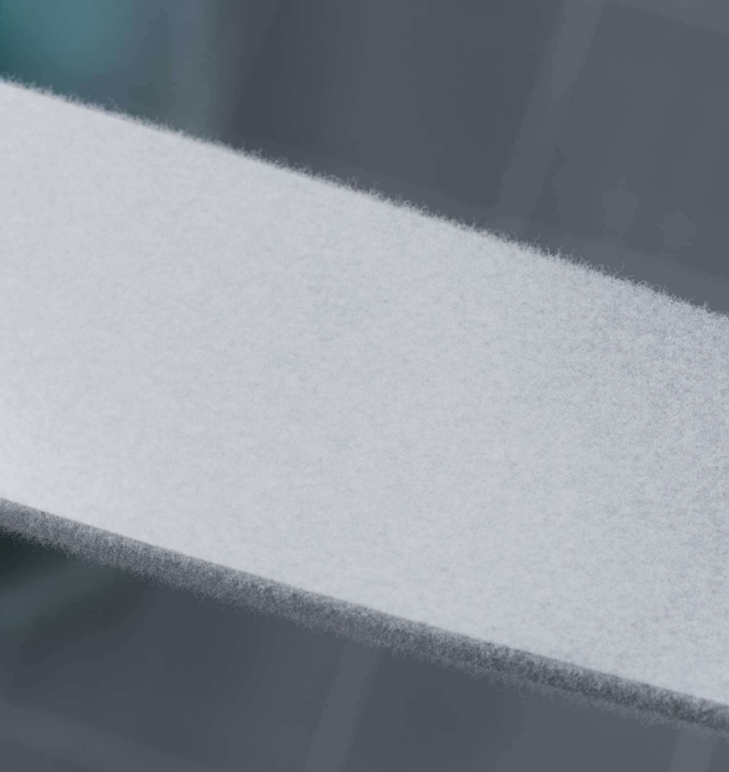

Huge improvement but it’s a tough cookie. Had some other things to finish but might give it another try. It’s really a pressed cotton surface if you look at the macro’s so the fly away fibres are mainly on the sides where the material is cut. Surface is also more rough than I expected it to be.

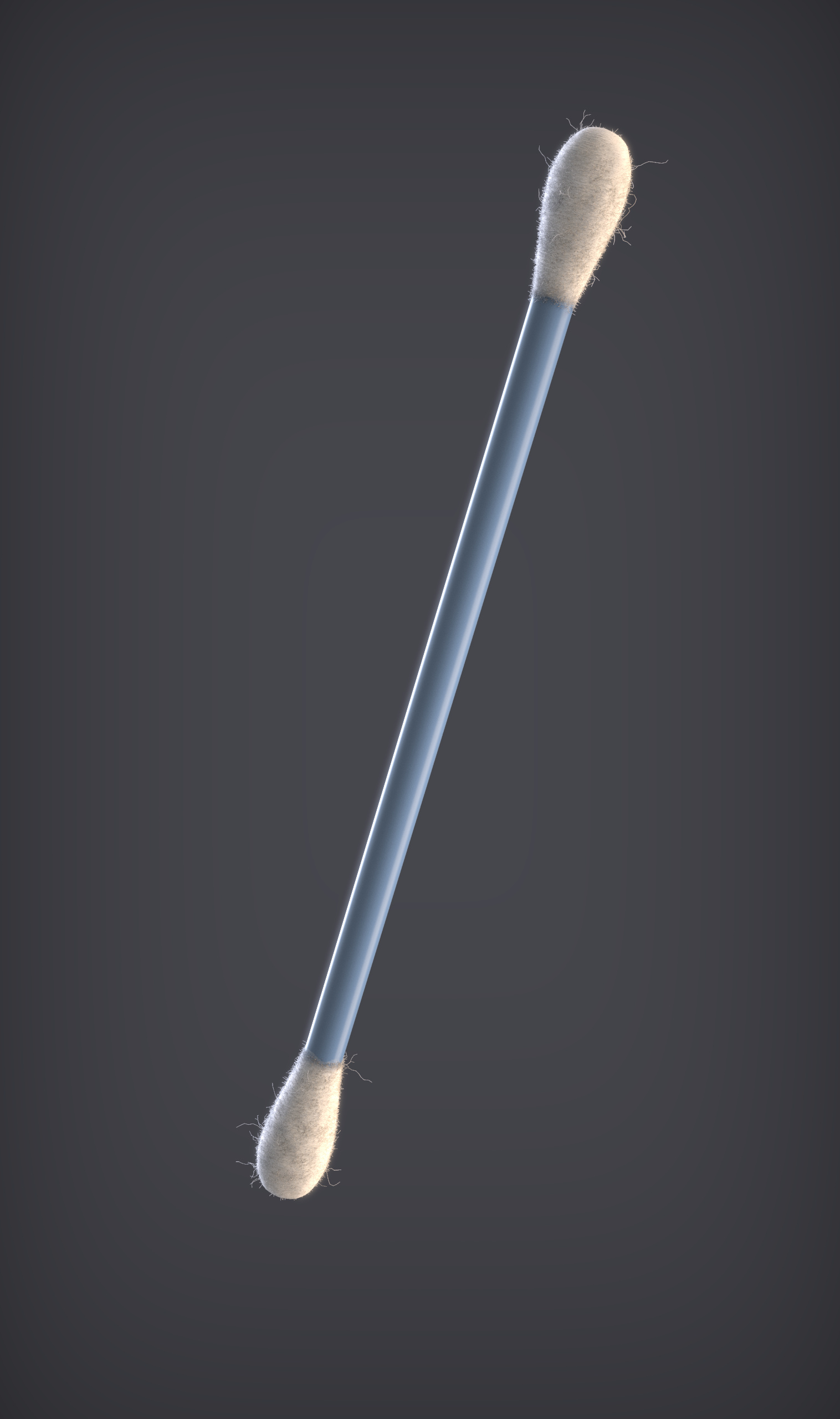

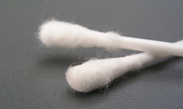

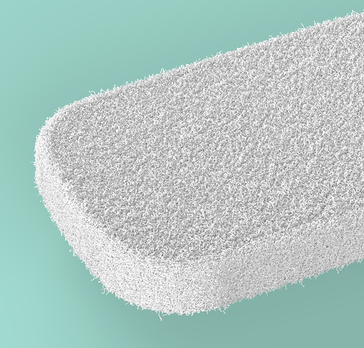

Yeah, I’ve found KeyShot to really struggle with anythign that looks like a paper/pulp composite. Things like this, fiberglass, wool, etc all are pretty much impossible. The closest I got was when I rendered this Qtip a few years ago:
So I have been out and decided to check to see if anyone had added to the thread and viola! It looks as though your adding an underlying twist texture and layering the fuzz over the top of that and then likely using an additional mask to vary that across the surface. That’s pretty close.
